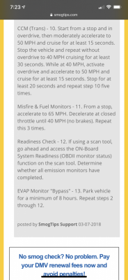

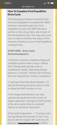

I had a problem with mine too, Guy passed me after multiple attempts. (Was a friend of the family) I’m not sure if it ever got working, but here are some driving tips I found to help get it done, maybe your just not hitting the right parameters.
