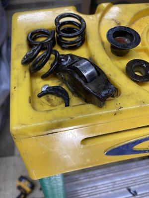

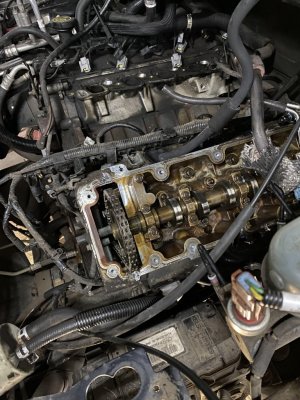

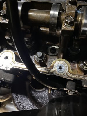

So i pulled the upper/lower intake manifold off and attacked the drivers side valve cover and pulled it off to find disaster - the #2 valve spring was shattered in pieces and the valve stem seal and retainer were just laying inside the head.
I couldnt see or find or valve stem so im guessing even worse...the vale has dropped in the cylinder head.

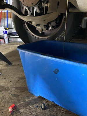

I'm obviously looking to pull that driver side head completely off, and drained the oil to find that milky mess.
