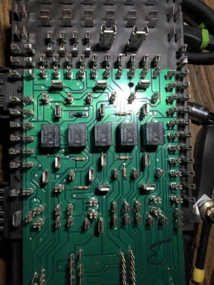

Had the same problem for a month and fixed it by replacing the micro fuel pump relay. It is soldered on the cjb board, have to take out the cjb and you will see 5 micro relays and it is the center one. You will see one on YouTube on how to replace it by unsoldering to take it out.

SEEMS RESOLVED: It was a bad relay for the fuel pump (R303). Found for $14 on ebay. Details below.
KEY TAKEAWAYS:
  • An OBDII diagnostic tool that can see specific manufacturer PIDs is at times VERY VALUABLE (I saved the cost of a MAF... basically paying for the tool I bought, because the MAF was not the problem).
  • Have a solder sucker for removing items from the circuit board.
  • A P0231 (only read by the more advanced tool) could indicate fuel pump OR relay.
  • The solution was a $14 relay found on ebay, by typing in the numbers off my old relay. (see the pic by @Expy3 above)
@Hamfisted - hit the problem right on the head on Nov 20 (above).
@RichardH - I also replaced the DPFE... did not fix it, but my old one had a broken post where the hose attached. I ALSO had trouble with a cheap DPFE and then bought a Motorcraft, which worked.
@Expy3 - Yep... that's the one I replaced. Great pics. Thanks.
BACKDROP: Truck ran well most of the time (some have had it die and not ever restart, but mine always restarted even if it took several attempts). But it would die when pulling out into traffic, making it dangerous.
TRIED WITHOUT PRIMARY SUCCESS: EGR hoses were needed, DPFE had bad connector for one hose, cleaned MAF (worked for 3 weeks so I thought this might be it). Cleaned throttle body (no effect). Had to replace starter in the middle of all this (independent problem). Traction control twice faked a problem (likely has corrosion, but it's low urgency - will look/clean later). Disconnected battery for a long time (no effect).
FUSE BOX: At first, I saw no burn marks (surface examination) so moved on. Replaced fuel pump (no effect - DAMN - costly, but still far less than the 1300 quoted).
RETURN TO FUSE BOX: Removed and examined closely after learning where R303 is (see @Expy3 photos above... that's R303 - the fuel pump relay). That relay is known to go bad. NOTE that everything at first looked fine when I removed it. But on close examination, there was slight (and I do mean slight) discoloration around R303... the center relay. That was enough to push me to replace it.
CODES... My only tool at the time was a BAFX OBDII tool & Torque Pro combo. This showed no codes. My thought at the time was a bad MAF sensor. Nope. I then bought an Autel ML629 and it read things that my old setup didn't... I got a P0231 - Fuel Pump Secondary Circuit Low. (The pro somewhat understandably said it was a bad fuel pump, but that was wrong.) The ML629 has profiles of many manufacturers and is clearly a more complete tool for special aspects (PID's - Parameter IDs)... it sees many manufacturer IDs that my older diagnostic setup could not. This turned out to be very valuable and PREVENTED me from buying a MAF - which was my planned next step. SEEING the message caused me to remember what @Hamfisted said and question the relay.
PROCESS FOR RELAY: Basically, unsolder the R303, and solder in a new one. SOME DETAILS (for anyone it may help): To see the area, you must remove the board like in @Expy3 's photo... and then track where the tabs go (NOTE CAREFULLY their orientation and take a picture) and then remove them, so you can remove the board from that back panel. Then you can get to the underside where the relay pins are soldered. Unsolder the R303. NOTE: Get a solder sucker. I'll admit that I used an air compressor to blow off the solder, but the big drawback is that the solder spreads out over the electronics. Mine was easy to clean off, but it made me uneasy (and small solder bits could remain). I'm getting a solder sucker next time. Once the old one was free (a bit of a pain), soldering in the new one was not hard. Careful not to melt on gobs of solder... it may spill over onto other circuits. Put it back together referencing pics to get it right (I used my pictures SEVERAL times even though I had expected that I would not need them. This has been working for over a week of very frequent use.
KEY TAKEAWAYS:
