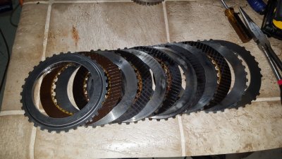

metaldrgn
metaldrgn
Mar 8, 2011
452
36
somewhere
Here's a picture of the of the fwd CP that was in the original transmission that came out.

Thanks for the info! Yes with transmission stuff I always torque to spec. I actually bought a used mechanical diode as the one that was in there doesn't turn either direction by hand. All gears before I took it out worked fine though, but I'm sure it may have caused problems in the future. The Belleville spring behind the reverse CP is also broken. I keep forgetting to buy another one to replace it. No issue with the reverse CP though so maybe it was more recent. I have the ATSG now and will also reference it for installation. I'm going to replace the bearings and some of the bushings and torque converter.
Did you ask the salvage yard for another trans. If that one was bad they may give you another. I would give it a shot.

Yes and I just want a refund at this point. They said they could have their transmission guy look at it and rebuild it, but I'm out labor, fluid, filters, and seals so I don't want to do this more than I have to. Not to mention it's a lot of work pulling and installing this thing on the 4x4 model. They said they would do a refund if I wanted. I'm fairly confident the old transmission shouldn't be too much of a problem as all gears worked, just started slipping after a while of driving. All seals that I've looked at are in really good condition. Everything except the forward clutch pack, Belleville reverse spring, and mechanical diode are good. I will be double checking. In the mean time I'm shifting to removing the old transmission. I want to solve that issue sooner than later. Maybe on days I don't have a lot of time I will keep inspecting and listing all the stuff I need to do this rebuild. I don't really want to buy a huge kit if I don't need it. I will be getting a shift kit and some other things that resolve other known issues with the transmission to make it last a little longer.
