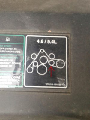

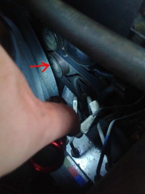

Can anyone tell me what this pulley is called?

It would be easier to determine which pulley it is by posting a pic of it on the engine instead of a label.

Temple, Georgia
Looks like an idler. Depending on how it is made (metal or plastic) it will require a replacement or just a bearing swap. Quicker to replace the entire assembly if you don't have the tools to swap out the bearings.
Most autoparts stores should be able to get what you need. Daco is a brand that I used back when I was buying parts for the county school system.
