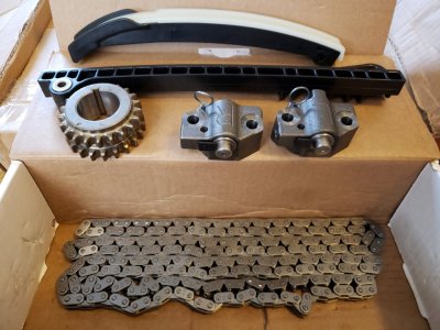

Well got everything in today. The Melling kit seems pretty nice. Figure I would post a couple pics, only have 1 for now.
Cast iron tensioner with a nice smooth clean surface.
