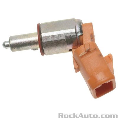

Probably the driver's door jamb switch just needs to be replaced. It's the most common to fail on the Expy. That'll get rid of your Door Ajar message and fix the associated issues with that. I'd use a synthetic 10w-30 oil in the motor. A tranny flush if it hasn't been done before. Lower ball joints if they haven't been replaced already. That's about it unless you see some outstanding issues that need attention.
Gen2 Expedition Door Jamb Switch ....
