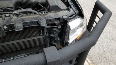

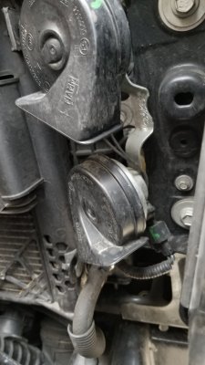

Here's a pic of my 2016. I removed the grill and headlight for a better picture. @tgams trying to get a good picture of the wiring harness proved to be too difficult. There's always the option to get an air horn. 20190606_192359.jpg 20190606_192409.jpg

@tgams sorry it took so long. Once I realized it wasn't easily visible I decided to wait for when I was doing something in the area. I removed my xentec hid kit because the ballast died after about 7 months.
