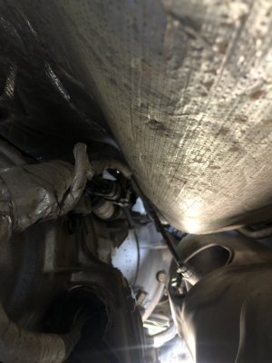

2013 expedition, where the heck is the output speed sensor1
Orionn1
Oct 4, 2019
Camarillo
I scoured the internet and I am unable to locate the speed sensor. There is nothing on the transmission that remote looks like the sensor. There is one place on the front of the engine on the driver side left of the belts that looks like the sensor and when I pulled it off it looks like it but it has oil not trans fluid on it and my replacement doesn’t fit it anyways.

Did you ever get an answer? I’m trying to change or my output speed sensor and also cannot find it.

6R80 automatic transmissions have both input and output speed sensors built into the lead frame inside the transmission.
