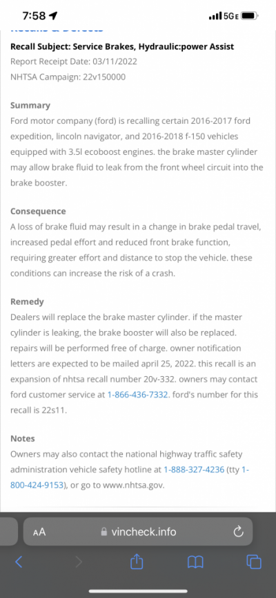

Wow… sorry to hear about that. Actually had something similar happen to my ‘04 Eddie Bauer. Ended up being the brake booster. It was leaking inside the vehicle.
What I found interesting while doing a VIN search on my 2016 came up with a campaign on the brake system. Hopefully this helps you…

Sorry for the late reply. I had to have it towed and then it took them until today to get back to me. Exactly correct Sir. The recall was the right call. thank you

Yes. The brake failure was finally diagnosed exactly as described in the recall. Thank you for the advice.
