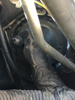

Back to the drawing board. I still have some leaking. I got this 2017 XLT with about 50000 miles in January that I’ve been trying to track down a water leak, thought I had it, then found it to still be around. I’ve had water leak in through the firewall (I think) onto the passenger side floor below and near the blower. I added silicone to both the grommet (thought it was through there, at first, maybe it was) that has all the heavy duty wiring going to the fuse box, and what looks like would be the heater (not really sure if it is). Still having an issue. I removed the blower motor because it looked like it was dripping from it and there was some water in there. About at wits end with it, though. I’ve assumed because of the mileage it’s out of warranty for something like this, maybe I should try the dealer anyway. Thanks in advanced with any help.
That really sux. The places in your picture are very doubtful to be the problem. They're under your hood and barely get splashed in a torrential down pour if ever. I'd be looking at your heater core. Are you sure it's just water or does it feel a little greasy/oily when you touch it?
How is your a/c drain? Are you sure the condensation is making it out where it should?
It’s only after a heavy rain or when I have a hose run over the windshield, I’ve never noted that it was wet after just running the vehicle around, so I have my doubts about the heater core, but I’ve heard others mention it, so I guess that’s the next avenue to explore. I’m about as far as I can/am willing to go as far as tearing it apart. ‍♂️
