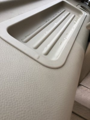

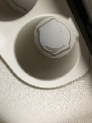

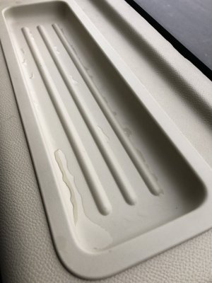

So I guess I am having similar water issues.
2017 Expedition El Limited
I purchased this brand new, no accidents and for the first 1 1/2 years it had been in the garage as an extra vehicle. Now that we are driving it every day we have had a weird water issue in the drivers side 3 rd row seat window area of the head liner.
It has been at my local Greenville Sc ford dealer.
Approximately 6 times now for the same leak.
So Far the dealer verified
1- sunroof drains are not the issue.
2- roof rack is not the issue
3 - replaced the power drivers side 3 rd row side window. 5 or 6 times
The leak has not changed
Nose up , nose down or parked flat it leaks out the same spot.
I can go through high pressure car washes. NO LEAKS
But every rain storm we have heavy or light I have water filling my drivers side only 3 rd row cup holder,storage compartment, and carpet on the same side is wet.
This has now been going on for 6 months and has been in the dealer for a total of 5-7 weeks with no resolution.
I picked it up last week with a no leak found but every weekend for the last 3 weekends in a row we have had rain and a wet interior. Yes I dried it up after each time I found water. We have to have a common issue here. I can say I have purchased many new fords over the years with no issues. I just want to find a resolution before I am out of warranty and before the mold starts inside my truck.

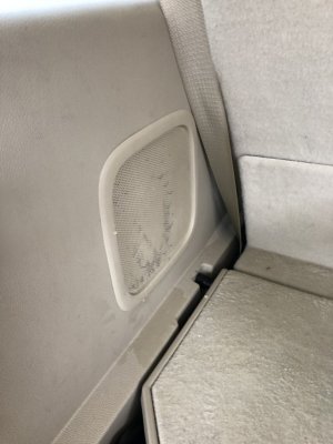

that pic of the rear area...did you look at the big vent window to make sure its closed or the seal is not twisted or bent?
i never open mine, not sure why they even have it as an operable vent

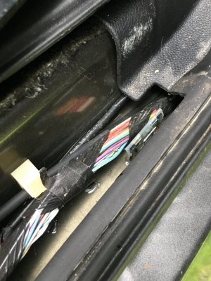

Crazy that this old post pops up right when I have issues with my 2017 XLT 4x4 (no sunroof). Heard a lot of sloshing when driving and turning, upon inspection found wet carpet on passenger side front and rear. I pulled the plastic fuse panel cover, then panel it connects to, and the floor panel and found the channel FULL. Does anyone know if water is designed to get in here, and since we’ve had almost 4 inches of rain here over the last 1.5 days, it’s just accumulated faster than it can drain? I would be inclined to think not, since there is a large bloom of wires going from the fuse panel to the rear of the truck. Any insight would be appreciated. Some of the pictures I took after pulling the rubber grommets from the channel to allow draining. The truck is parked on a slight incline in my driveway, maybe a little more than 1 degree according to the “off road” section on the dash.

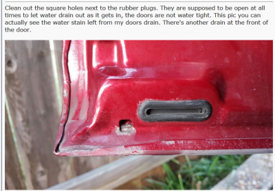

On the passenger side getting wet at the door, first check the drain holes in the bottom of your doors. Make sure they aren't clogged. If that happens, water can build up inside the door itself.
Now, open the front door. Check for Stink bugs wedged in and around the weatherstripping. Yes, these nasty buggers can cause leaks! Been there. . .
Next, carefully remove the weatherstrip around the door opening in the body (it just pulls off). Be sure to go all the way around. The weatherstrip has metal inside so it can grip the pinch weld in the sheet metal around the door opening.
As you remove the weatherstrip, check to make sure no portion of it has been pried or left open in such a way that it won't have a tight grip on that pinch weld. Also check the pinch weld itself for metal burrs and remove those with a file (they can keep the weatherstrip from sealing properly). If you scratch through the paint while doing this, be sure to touch it up.
If any portion of the weatherstrip was pried open, gently squeeze it closed again with your fingers. It should be open just enough to fit onto the pinch weld but no more.
Reinstall the weatherstrip, making sure to gently squeeze it fully closed all the way around the opening. It should grip snugly.
You might want to repeat all this for the rear passenger door, just in case. . .
