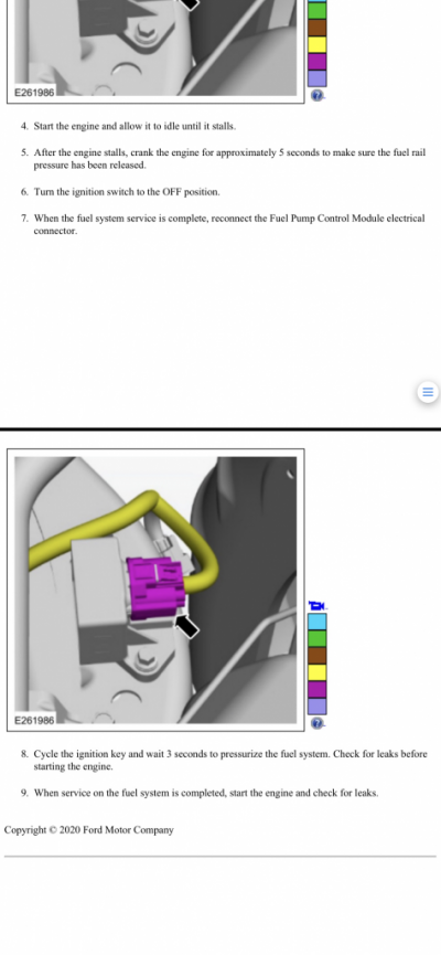

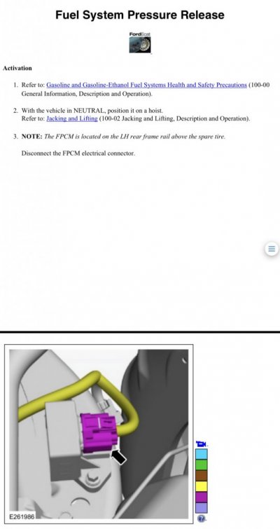

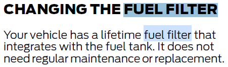

I searched the forum and got no results for this... I haven't looked at my vehicle yet but wanted to know where to start before I started this.
Is it on the frame some where near fuel tank? Anyone have pic or diagram?
