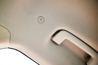

Another better option is to unplug the ANC microphones. There are 3 of them in the headliner. One above both front row seats and one in between the second row seats. They look like this.
Pull them out and unplug them then push them back into the holes unplugged it you want it off for good.
