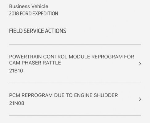

Has anyone have this pop up in their FordPass? (And did it change the way your dad expedition drive?) It’s reprogramming for Cam Phaser Rattle and PCM engine shutter. I’m curious as to what these are supposed to do? Thanks.

I have a 2019 also. No engine problems currently. I have the same thing. Both codes in my Ford App
I wish they would explain what we’re taking it in for lol. Glad I’m not the only one. I took it in. It took almost all day. Rides the same.

2963A3B1-B7FC-4BB1-BDD1-8842720DAF54.jpegBrought my 2018 into my local Ford Service Dept this morning to address these items. Engine rattles at cold start for a couple seconds due to no oil on the phasers. Was told it would take 2 weeks for them to complete the service and they are out of rental cars…

View attachment 70614Brought my 2018 into my local Ford Service Dept this morning to address these items. Engine rattles at cold start for a couple seconds due to no oil on the phasers. Was told it would take 2 weeks for them to complete the service and they are out of rental cars…
Same here. They also said Ford hadn't released the software for the Expedition, only for the F150. Ridiculous...
