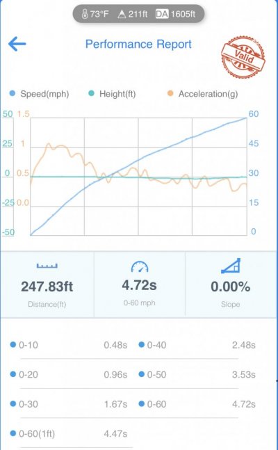

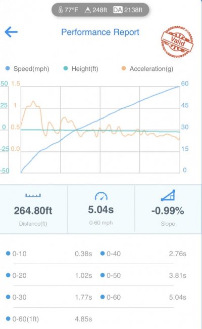

Got any times in your Expy with 93 in the tank? Power claims are one thing, but real world numbers talk.
Nope, those are the listed specs for the tune so take it with a grain of salt. Nothing out of line with all the other tunes I looked at though, so not really suspect. I did not have it very long before adding the tune. It just feels good & very quick to me, and pulls like a beast with the heavy trailer behind it.
