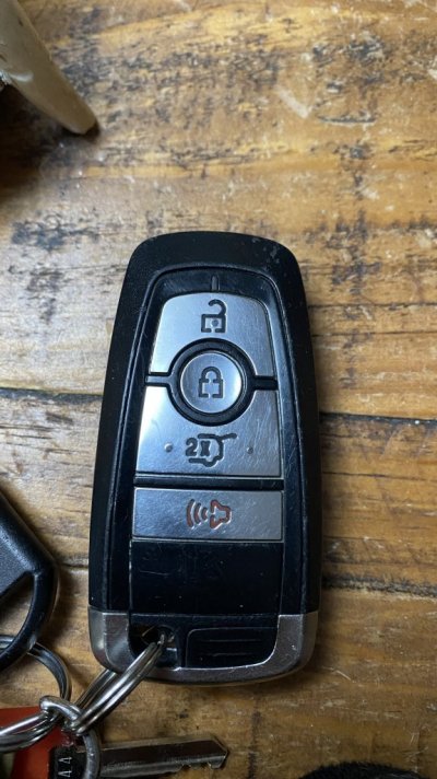

My new to me 2019 Expedition XLT with the 201a package is missing some things that I really desire.
1. Ability to remote start to cool the truck down in 100 degree Texas summer
2. Ability to leave my keys in my pocket to unlock and lock the vehicle
My used truck came with a single large, 4 button keyfob. I would like to know if this key fox is deemed an "intelligent access key"? My understanding is this type of key is required for key's in pocket unlock
I have been looking at the perimeter plus security addon for the remote start feature but as I understand this, it uses the fob I have with the lock-unlock-lock key sequence to start the truck. After I add the module will this support the 5 button intelligent access key so I can use the remote start button on the fob?
And if so, do I need to have any other addons to enable key in pocket vehicle entry? I have obtained Forscan with the advance license and also the OBDC MX but haven't started exploring with that yet. Can I use this to determine any capabilities for the intelligent access fob?
