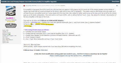

So after about 500 miles I just couldn't live with the "crisp" (OK, it sounded crappy) sound at high volumes. Sounded fine for regular volume, but wasn't great for high volume. If my wife says something about bad sound, I know it is an issue.
After some research, Ford actually tunes out bass for their low end speakers to keep them from blowing, especially at high volume. I was about to install a LOC converter to fix the issue (another $180), when I came across a FORSCAN code(s) that deletes out the factory sound tuning and knocks the signal down to pre-amp levels. Both codes 100% worked on Expedition (the non-Sony code):
http://www.2gfusions.net/showthread.php?tid=3704

I’m still happy with my Forscan fix for the EQ. I actually ordered a aftermarket equalizer, a LC6i, and returned it because i didn’t need it.

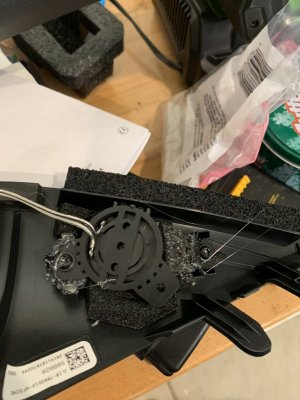

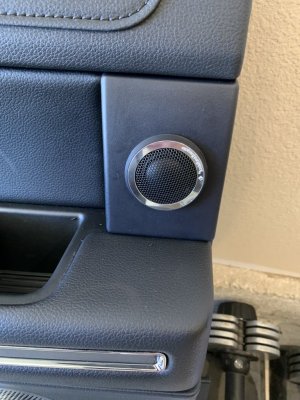

Added a tweater in the factory spot in the rear door (lots of dremel use)
Backside of the rear tweeter install.

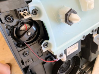

Front A pillar tweeter replacement (yes, I used hot glue, and have had no issues).

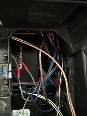

Amp buried below the gear selector in the center “dash” area.
