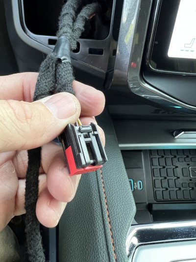

Some of the f150 i know have pigtail plugged into a blank connector to hold it from flopping around. You need to look real good

Do you mean a different blank connector than what is in the back of the coin tray??

Might be on the dash support framework. Was that way on one of my f150s.
