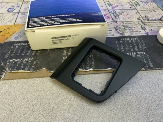

There are only a handful of people who even have a 2022 at this time so odds are you likely won't find someone who has done that yet. Having said that, there are a lot of smart folks on this forum so I'm sure someone will have some incite. You would think the 21/22 F150 brake controller would be the same as Ford wants to share parts where they can. Not having wires behind that blank doesn't sound good IMO as I thought the older (18-21) had that wiring regardless of the tow package.
I'm thinking if Ford didn't need to put something in the vehicle that MIGHT get used they just didn't. With all the supply issues I'm sure that's going to be very common these days.

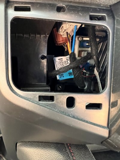

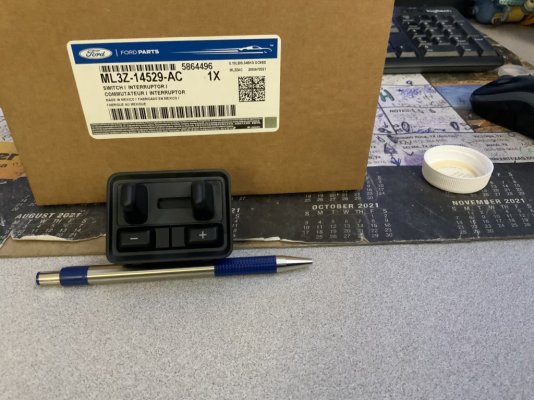

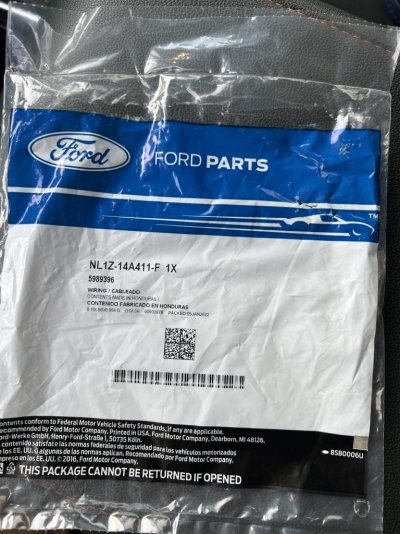

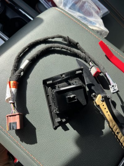

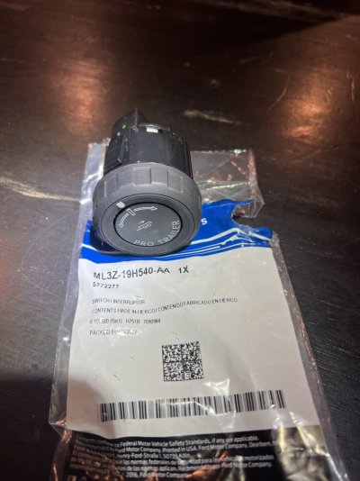

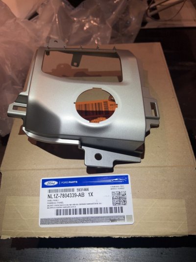

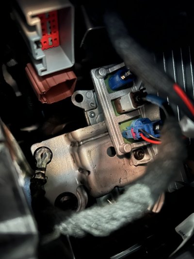

I have a 2022 expedition timerline, it is not equipped with the heavy tow package. However, I have been looking for the components for the intergraded trailer brake. I have came up with a few parts. As you can see the pig tail is different. I did get a part number off a Expedition Timberline that has one factory installed. The plug that both pig tails plug into, appears to be the same. At this point finding the pig tail is the issue. I am actively looking, I am close. I am not sure ”yet“ if the complete pro towing backing is fully needed. More to follow
Thanks for finding all these parts, any luck on the pigtail yet?

The pigtail is the one for use of aftermarket trailer brake controller. I installed the parts I have, I’m still working on the pigtail.

pigtail for the trailer brake.
