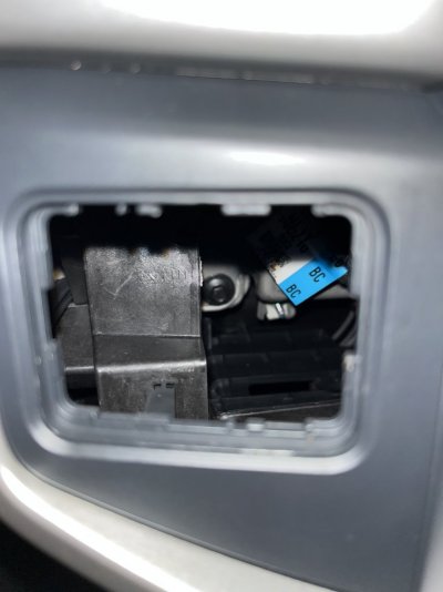

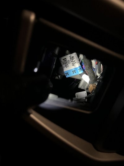

Unless you’re seeing something I’m not, all those cable run to the climate controls and infotainment system

I discussed with technician at dealership. They confirmed with me no plug wrapped behind the coin spot. They said that hole is not fit TBC model number: JL3Z-19H332-AA.
They said TBC F150 2021 may be fit that hole. TBC part number: ML3Z-19H332-AA
Im still waiting update from Ford. Expedition Timberline is still new model.

My dealer tech said the ML3Z-19H332-AA kit should work in the 2022 Expeditions, the only kicker being there isn’t a pigtail behind the coin holder.
It might not be hanging loose. My old Honda Pilot was prewired for a number of things and most wiring harnesses were zip tied up and out of the way so they would not rattle. I would not be surprised if that was the case.
Man, I sure hope so. I guess that means the dealership is gonna have to tear the dash apart to get to it though

Some of the f150 i know have pigtail plugged into a blank connector to hold it from flopping around. You need to look real good
Do you mean a different blank connector than what is in the back of the coin tray??

Might be on the dash support framework. Was that way on one of my f150s.
