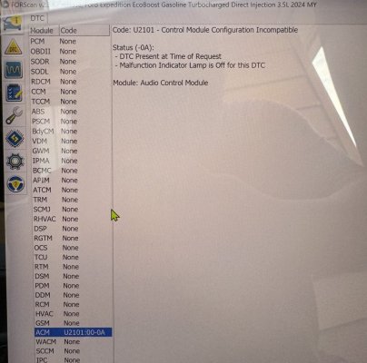

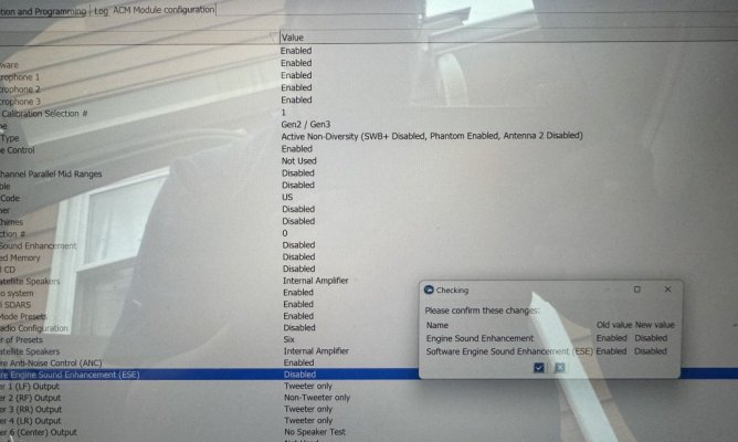

Hello, just an FYI about the fake engine sound ... I have a 2024 Limited with the SPP (304A), I disabled "Engine Sound Enhancement" and "Software Engine Sound Enhancement" in the ACM section using Forscan.
Now I get DTC codes in the ACM when Forscan connects with code U2101 - Control Module Configuration Incompatible. I tried enabling just one of each and still get the DTC after each power cycle. Only way to clear the DTC code is to leave both sound enhancements enabled.
The car is a lot quieter with both disabled though, and still accelerates the same. Bambi mode works fine though, no DTCs for the BodyCM (that's how it's named in Forscan, instead of just BCM).
