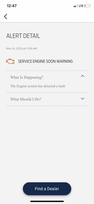

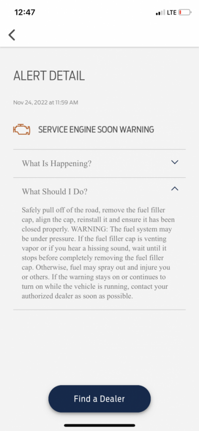

Anyone have a Service Engine Soon light on a 2022 yet? 6k miles. FordPass suggested action seems a little off.
