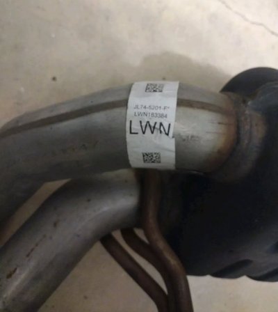

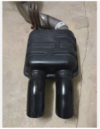

I had a few goals and criteria in mind, and here they are:
1. Flow enough, for the power level I am at (800 Crank), without boost lag caused from a high back pressure muffler (like the factory expedition single in/out original muffler)—that stock expy single in/out muffler is okay for stage 3 turbos, but only so much beyond that.
2. Good boost response/no turbo lag
3. Be as quiet as possible while highway cruising and especially towing & general driving around town (I’m too old to want to hear noise & drone on an all day drive)
Think of what I did as a Lincoln exhaust with a high flow downpipe with high flow/legit cats. (GESI, G-Sport)
It’s pretty quiet until you really get on it, & then it makes a some nice noise, but not in the bad uncomfortable frequencies, and no drone anywhere, and the boost response is the best of anything I have tried.
How do I attach some videos ‍♂️
Silver-Bullet-Bus
Apr 26, 2022
96
42
South Carolina
It’s pretty quiet until you really get on it, & then it makes a sime noise, but not in thebad uncomfortablefrequencies, and no drone anywhere, and the boost response is the best of anything I have tried.
How do I attach some videos ?
Silver-Bullet-Bus
Apr 26, 2022
96
42
South Carolina
Funny thing, I was just with a friend in Vegas that has a new Tundra, he did an exhaust and funny enough it sounds as bad as these do with an aftermarket. It seems these dual turbo v6's either need a $5k exhaust to sound good or just stay stock. Anywhere in between they get grumpy.
I too am pretty tired of the sound in the cabin with my aftermarket but I've tried over three different setups and I'm kind of done wasting money. The way things are going on these i'm not sure if i'll have it long enough now to make it worth dumping more money into.
I am curious though, what makes say the Lincoln muffler do better than a lot of the aftermarket ones. For one, there are plenty of reports (more so the single expy exhaust/muffler) of these stock ones blowing their wads. But given how much I've spent on my exhuast over the years, would it be worth just buying the muffler assembly and having my exhaust guy fashion a single to dual section for the inlet and dual to single for the outlet? What about the giant stock resonator in the back, is that what makes the difference? Hard to teill. I'm running two resonators today, a big one in the center and a smaller one at the rear. I just can't stomach dropping another $2500 to $3k on stock parts.
Well, the duals are quieter, (& it is duals from the downpipes, all the way to the back) because it’s easier to control the sound in two small pipes, than one big pipe, especially, the bad unwanted frequency range of sound.
Additionally, it’s because Ford spent a lot of money designing that Navigator muffler, and from my initial use, it flow better than anything if tried, and it’s quieter than anything I’ve tried. Think of a navigator, with high flow downpipes.
This is how the new expeditions are set up also.
Yes, I blew out a few expedition muffler too, the middle one & the tailpipe resonator too.
Junkyard baby—that’s where I got all the navigator parts to try!
$120.00 for the two front pipes from the downpipes, to the dual center muffler.
$350.00 for the center duals with uncut pipes.
$150.00 for the tailpipe section
…& custom fab install shop his fee to weld in to the downpipes & install it all (the downpipes had to be removed for welding & fitting)
Really happy I went this route after trying several different thing.

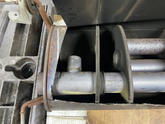

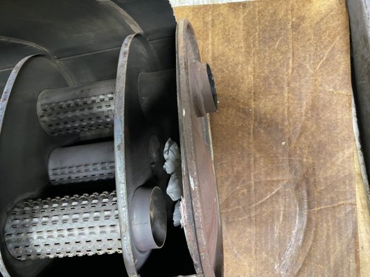

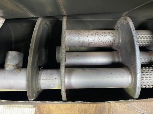

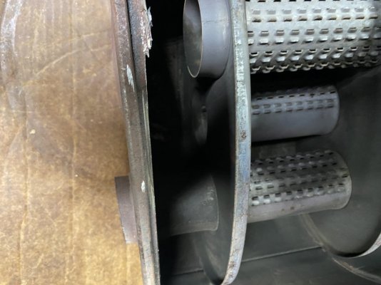

See pictures: Here is why you original, single-in/single-out expedition muffler, blows up internally, and probably why they are now using a more Lincoln Navigator style muffler on the new expeditions.
this is interesting but what's the Navi muffler look like in retrospect? I also don't see any packing material in there so is this from a "blown" muffler?

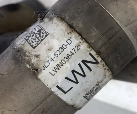

Don’t quote me, but I think in 2018, the navigator might have had duals underneath & a single tailpipe/option. The critical thing is you need an navigator “L” center section & navigator “L” rear section if you have an expy Max.
I’ll post some part numbers that worked on my max, and you could also look at the new part numbers from the new expy’s.

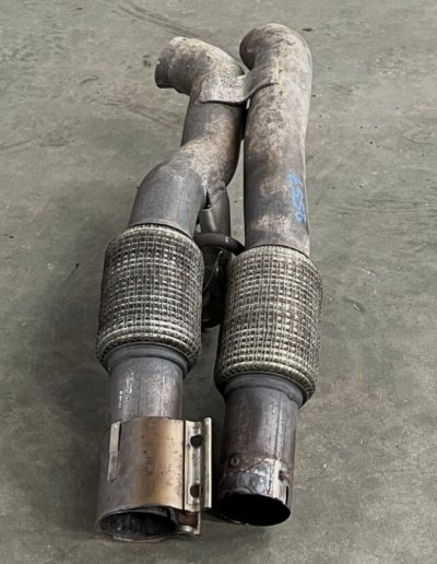

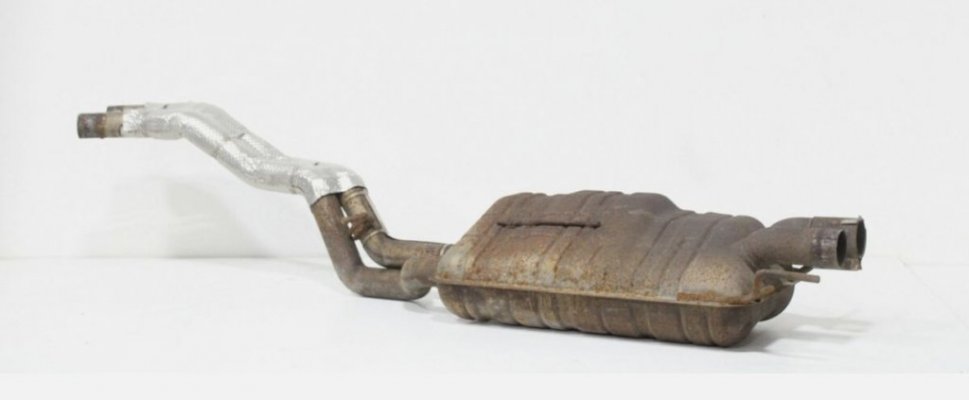

This is the front/center muffler with the over axle pipes attached, that I used.
From my research, the heat shield parts numbers were the same from Lincoln to Ford, which was my big clue that this would work out.
The packing material everyone including me has experienced, comes from the tailpipe resonator, not the middle main muffler. …but I blew apart the welds in the big middle muffler, and then tge internal plates were rattling around, in the big restrictive muffler.

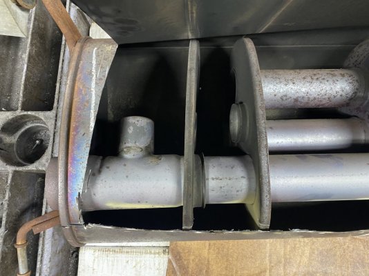

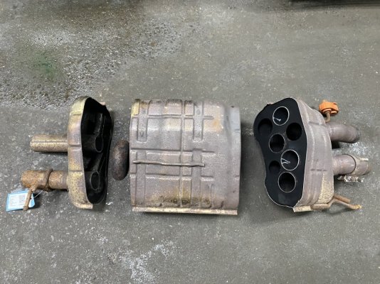

I wonder how many million dollars $$ ford spent designing this Lincoln muffler?
It’s everything they told me a muffler Could Not be: good flowing & quiet!
It’s a free flowing,
no packing,
reverse flow on one tube,
multi-hemholtz-chambered & valved on the exit pipes!
Quite a marvel of engineering.
Let me know if you want to see more photos of it.
