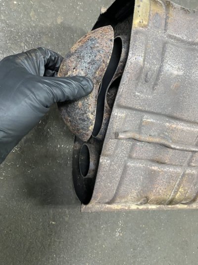

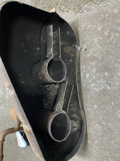

I just want to better understand the difference between this and the expy muffler, it's far harder to convert the expy single 3" design to a dual 2-5/8" design or whatever diameter it is. It also seems insane that no other aftermarket muffler can reduce drone and in cabin noise like these can, i've tried many.
Yup, I tried a bunch of different mufflers & configurations & the drone was terrible.
Persnickety drone harmonics on this motor.

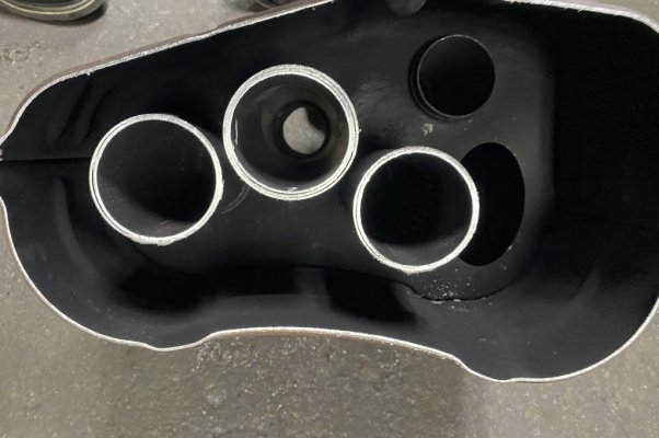

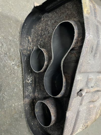

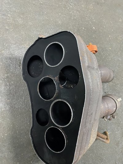

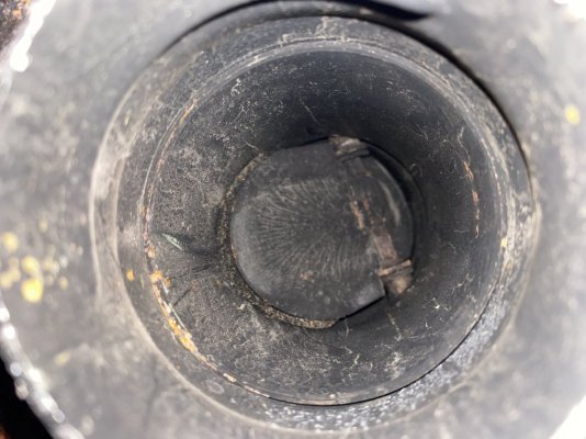

Now, each bank runs by itself down to the navigator flex pipes, (which incorporates a factory dampening device) to the dual-in-dual-out navigator muffler & Siamese dual over axle to dual-in-dual-out navigator rear resonator. It’s loud enough on start up & no drone anywhere & flows great with the big turbos. I feel that it is in no way inhibiting power output, because the two pipes are equal to 1 pipe @ 3-3/4” diameter.
Silver-Bullet-Bus
Apr 26, 2022
96
42
South Carolina

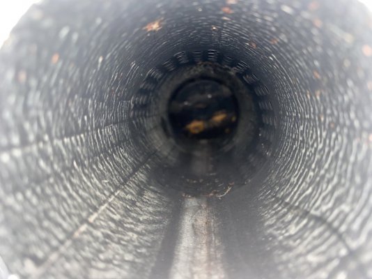

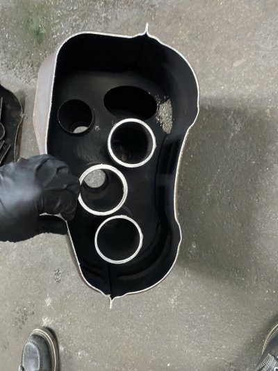

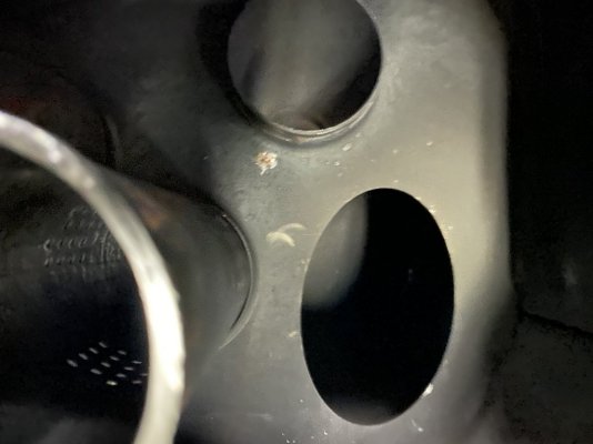

I wonder how many million dollars $$ ford spent designing this Lincoln muffler?
It’s everything they told me a muffler Could Not be: good flowing & quiet!
It’s a free flowing,
no packing,
reverse flow on one tube,
multi-hemholtz-chambered & valved on the exit pipes!
Quite a marvel of engineering.
Let me know if you want to see more photos of it.
