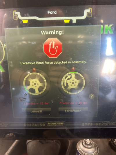

Got my vehicle back yesterday. Nothing really fixed. For the vibration, they decided to road force balance the tires and all of a sudden two tires are faulty. Apparently, all the previous balances have just bee regular balances without road force. According to them, if a customer wants a road force balance they have to specifically ask for it. I guess asking "Hey, do you guys do road force balancing" and then "OK, I'd like a balance" isn't good enough..
Here's the kicker - they're saying that I have to pay to have the tires replaced. The tires have too many miles on them for Ford to cover them. It doesn't seem to mater that I've had the issue since new off the lot and they've balanced the tires four times now.

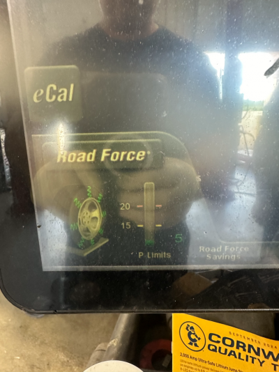

Picked the Expy up on Thursday evening last week. Took the Stealth to Gainesville, FL from Miami, FL to witness compete destruction. My service rep said the field engineer stated it was a 'balancing issue'. Driveline was fine. They road force balanced the Defenders...
I must say that it was vastly improved. But still... at 74MPH there is (less pronounced) 'shimy' in what appears to be the driver's side front only. It's pedal and steering wheel. I pushed the vehicle to 90. It seemed to dissipate. My passenger knows the entire history and I had him on the look-out for vibes. He repeatedly said it was smooth, even at 85+. I can detect it while driving and can probably live with it. Just took so much damn work to even get to this point - without complete eradication. I will probably shop elsewhere for this class of SUV next time - unless they correct this issue.
Get Defenders and road force balance. Check for dents in wheels. Pretty much all one can do.

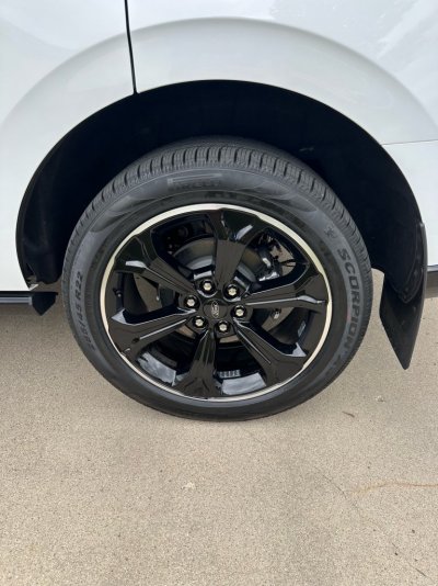

Vibration is gone! Finally got the Pirelli Scorpion AS Plus 3's mounted on and could not be happier! No vibration or shimmy felt at speeds up to 85mph. Very smooth and quiet tire! 100x better than the stock General Grabbers!
