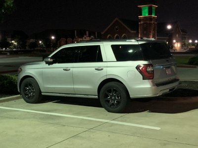

Just mounted Michelin Defenders 275/60R20 on +30 offset wheels (Black Rhinos), and not just no rub but thinking that I could have gone bigger :-D....anyway, works great here...

not the best pics...but I really like the combo, drives smooth and looks imho very nice. AT tires would look cooler, but I do to many highway miles that this makes sense ;-) form follows function. Always....;-)
these are the BR Mozambique. The flow form production should make the light...I think around 28lbs
View attachment 31261View attachment 31262
Stock height?

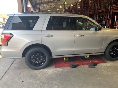

I just got the Falken Rubitrek AT 275/60R20 tires put on my 18 Expedition and they look amazing! I haven’t drove it yet, hopefully no rubbing will occur on any bumpy roads. It’s all stock
Any pics? I wanna judge for myself.

Pictures of the Falken's would be nice, tho.

sjwhiteley
Nov 28, 2019
538
331
Kentucky
They scratched my rims on the machine and are fixing the issue this week, so sorry for the dirtiness on them. I'm upset I haven't been able to make them clean looking yet. They ride beautifuly. I rubbed once making a complete turn in my driveway though.
Fantastic. They look a lot more substantial than the size would indicate. I would not have thought they would rub: do you have an idea where it was? in the turn was it on the inside or outside wheel?
