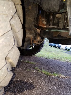

Any ideas what this is? Close to the battery/front passenger side of car. I'm thinking tranny or power steering fluid? Only oily fluids I figure would be over in this section. Didn't bring wrenching clothes so didn't want to lay on the ground to take a better look/pic but when I think about it... Definitely would be cheaper than breaking down on the way home lol
Guessing trans fluid I figured it has a trans cooler in the radiator and the hose with the metal is trans fluid? Gonna get under there and just say screw the clothes. But I still have to get home if I can and to the shop this week sometime..
Visiting family who are less mechanically inclined than me =/ worst case I ignor it til my kids go back to their mom and take it to a shop tomorrow... Thanks for any help!

Check the power steering and trans fluid levels. Over time driving one should be dropping. Not seeing the red trans fluid color I'll venture a guess at power steering fluid leak.
