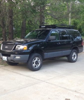

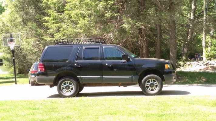

Just wanted to finally start my own thread for my truck.

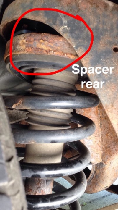

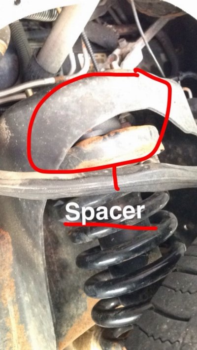

Starting with the lift, it was installed today but I won't be about to do a complete write-up because I didn't have the right tools at my house to do it myself so I paid a local shop to install it. Basically, as many people know a leveling kit is a spacer that fits on top of the strut and when bolted back onto the truck that way, it gives the truck a higher stance. I purchased the 3.5" front kit ($44) Steel Front 3 5" Lift Kit F150 Expedition Mark Lt 04 08 2WD 4WD Free Shipping | eBay and the 2.5" rear kit ($60) Carbon Steel Rear 2 5" Lift Kit for Expedition 03 14 2WD 4WD Free Shipping | eBay separately. I think the seller has them together on eBay also but I'm unsure. A lot of information I had on this lift came from tallsville and his very helpful thread with him installing the same kit. http://www.expeditionforum.com/f47/spacer-lift-fronts-2nd-gen-17356/ I believe it is very quality kit and that it is definitely worth the money.
Below are just rough measurements I took with tape measure. Emphasis on ROUGH.
-Before lift
•Fender to tire
Left rear: 4.25"
Right rear: 4.25"
Front right: 4.25"
Front left: 4.25"
•Bumper clearance
Front valence: 11.5"
Rear bumper: 18.5"
•Sides
Drivers side mirror: 16.5"
Passengers side mirror: 16.5"
•Body
Rear hatch: ~76"
Front hood: ~46"
Ground clearance: *8"
-After lift
•Fender to tire
Left rear: 7.25"
Right rear: 7.25"
Front right: 7.25"
Front left: 7.25"
•Bumper clearance
Front valence: 14.5"
Rear bumper: 21"
•Sides
Drivers side mirror: 18.5"
Passengers side mirror: 18.5"
•Body
Rear hatch: 79.5"
Front hood: 49"
Ground clearance: 11"
Gained a lot of space everywhere and I believe that in about a month or so when the 35x12.50r17 Toyo Open Country M/Ts come in I'll be able to fit them nicely. Also have not 100% made up my mind but I do plan on going with MethodRaceWheels "Standard" in 17". Should, hopefully, fit nicely and give the truck some stance.

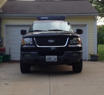

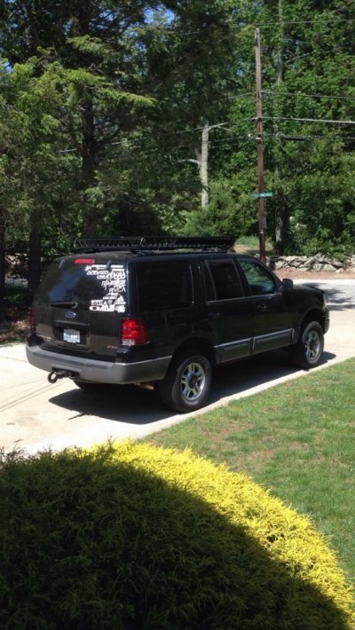

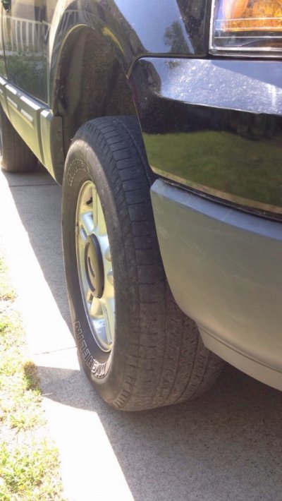

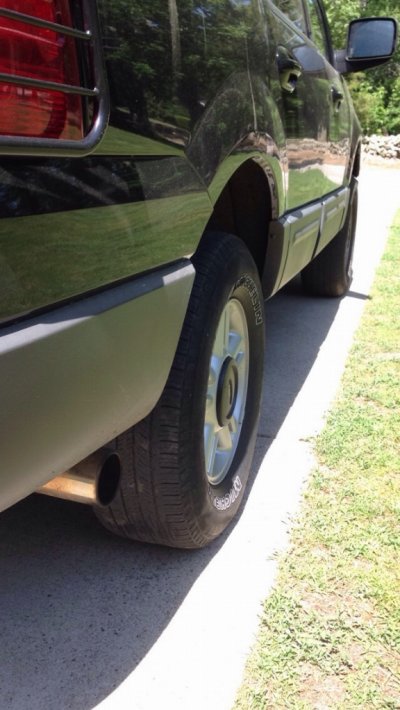

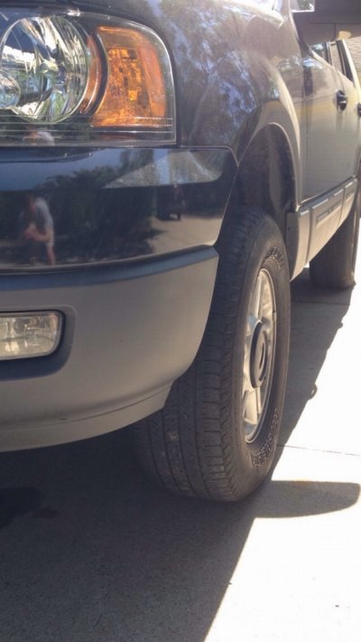

Here are a few pics thanks guys this forum is great and I have a lot more planned for this truck!
First 2 are before the lift and the last 3 are after the lift.
PS I apologize for any spelling errors beforehand...

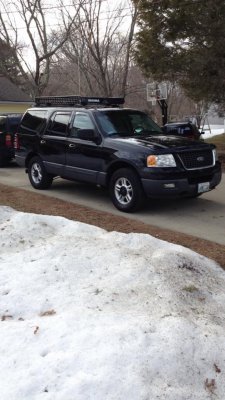

lol. But I will in fact be upgrading from these 265s to 35x12.50r17 mud tires and ill be running 0 offset Method wheels with either 4.75" or 4.5" backspacing... I'm hoping that that setup will have no/minimal rubbing for me!
