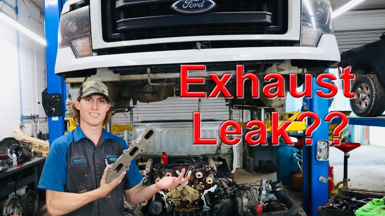

Here's a video I watched previously that shows what's involved in replacing the manifold.
