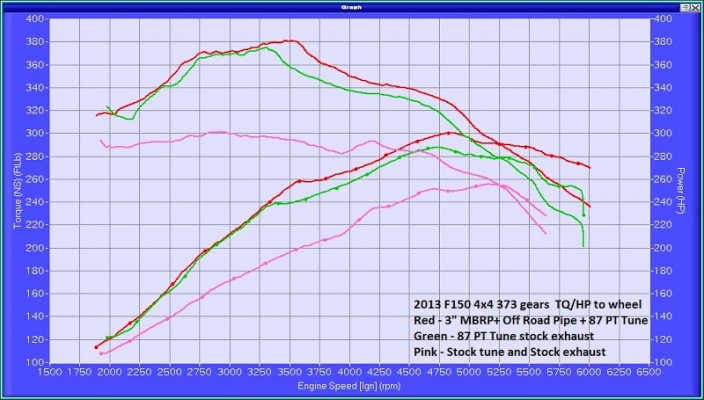

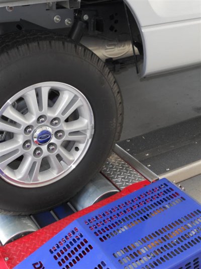

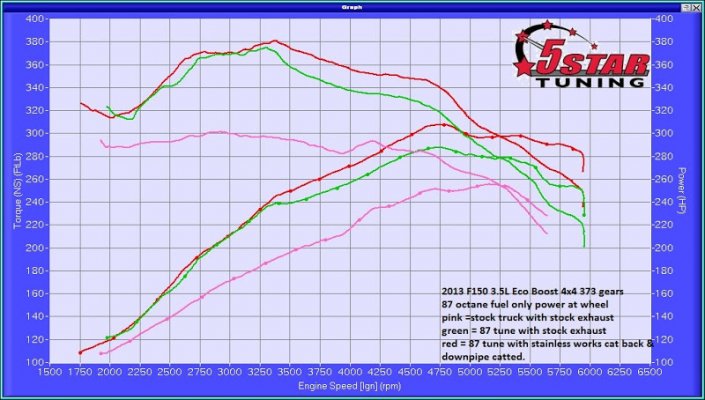

We have been hard at work this new year figuring out what works and doesnt work exhaust wise on F150's Eco Boost trucks. We Installed & Dyno'd 2 Different Exhaust Systems on F150 Eco Boost. Over all very good gains from both combinations.

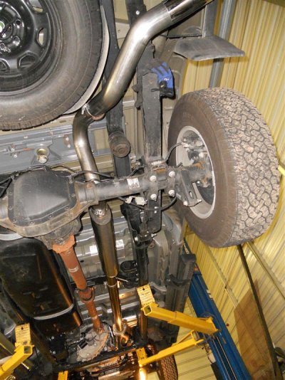

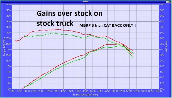

Combo 1 is MBRP 3 inch cat back with resonator and off road down pipe.

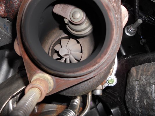

VIDEO OF TURBO WHISTLE
Ford 2013 F150 Eco Boost w 3"
mbrp & 3" off road down pipe turbo whistle - YouTube

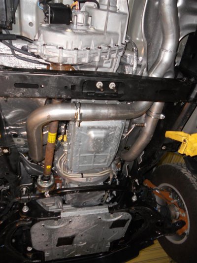

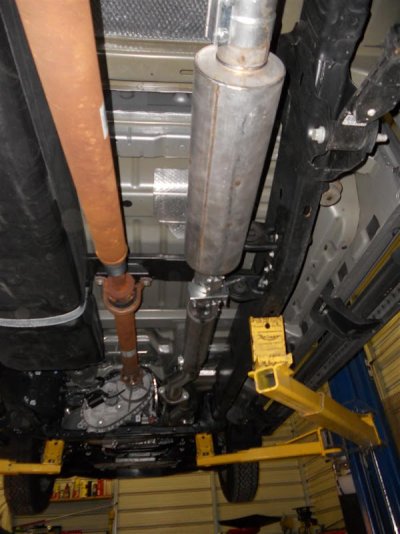

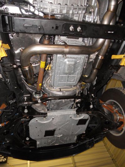

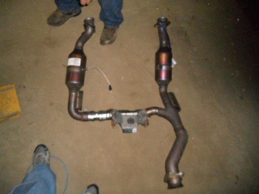

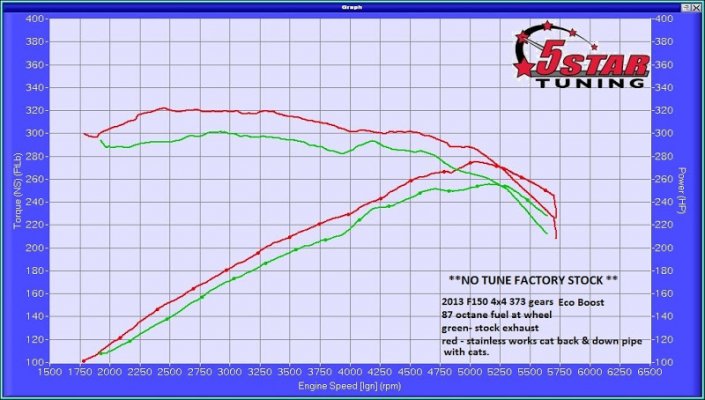

Combo 2 is Stainless Works Cat back and Downpipe with Cats
