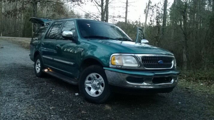

that sounds like my adventure. I got my '97 xlt for 400 at 274k and had her driving for just 150 in parts. intake gaskets and the metal hose under the intake. also needed a tune up. 4k miles later she is doing fine.
has new brakes all around rotors/pads. new air suspension bags and shocks ford oem parts by the logos stamped.
new water pump/tstat and it has the towing package.
bad- needed four new tires. spare tire hoist broke. needs some cosmetic work on the front, and needs front suspension work. last service was at 100k..so 177k later...she is creaking.
I need to make a proper album of the progress but my move to MI is really taxing me. album of the before pics
album of the cleaned carpet.
as she sits today:coz7doG.jpg
