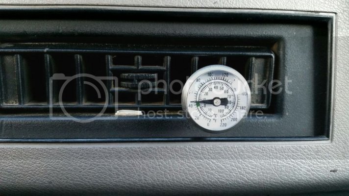

The 134a in my jeep had extremely high pressure and never cooled worth a damn, I'm talking 75° vent temps at best on a 100° day. The reason being is the condenser and evaporator design were never meant to be used with R134a which is a much less efficient refrigerant.
I got tired of it so I recovered my 134a and pulled a vacuum. I then refilled it with propane. Yes propane from a green camping cylinder, with an adapter I built. I refilled it by weight, just a little less than what it called for R12 wise. There is a calculation to compare R12 and propane, the propane is a slightly bigger more compressible gas than R12 from what I remember, so you used a little less.
I ran around with that in my system for about 6 months during the summer months. It worked GREAT!!!! My vent temps on a 100° day were right around 40°. The pressure were MUCH lower, my fuel economy increased, and I had a noticeable performance boost because the propane is easier to compress. But the pressure can get way out of control, that's why it's stored in heavy steel cylinders. You should really use a propane/isobutan mix, but I didn't.

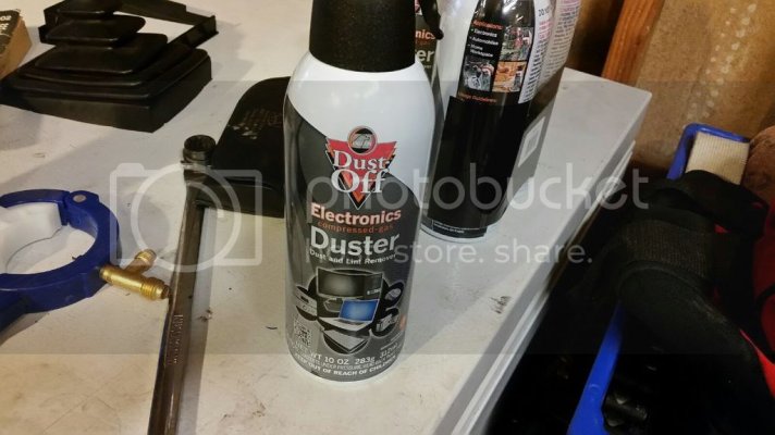

After a bit too much research I found R152a (difluoroethane). . . This refrigerant has almost identical properties to R12. . . and the best part is its SUPER cheap! And even better its completely legal to vent to atmosphere! I paid $8 for 2 cans.
I drained the system and flushed it with some AC flush, installed new seals and parts. I pulled a good long vacuum to make sure that the system was as good as it could be. I refilled the system by weight. The pressures were good, and the performance was GREAT!

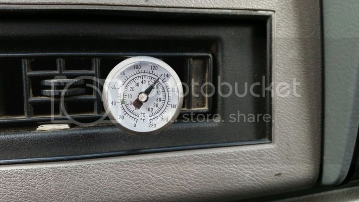

This is what I get into at the end of the day.
This is 5 minutes down the road with 152a in my clapped out Jeep. Sometimes it would drop below 40°, it was GREAT!

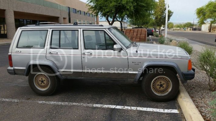

And the Jeep in question. A year of heavy use and it still worked great till the day I sold it.

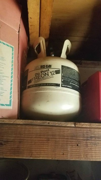

I've had the better part of a 20lb jug of r12 collecting dust in my garage for over 20 yrs! 0db05fb1e38cdb00395e3c2669e78027.jpg
