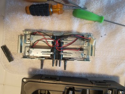

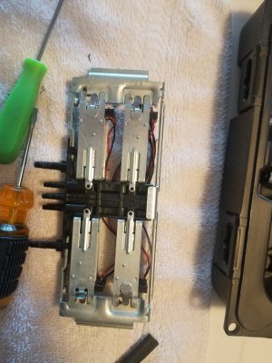

So while waiting on my mail, I decided to open it up and get ready for the first one. It looks like mind has tac welds holding the actuators in....UGGH. Back to the drawing board.20180627_120749.jpg 20180627_120801.jpg
