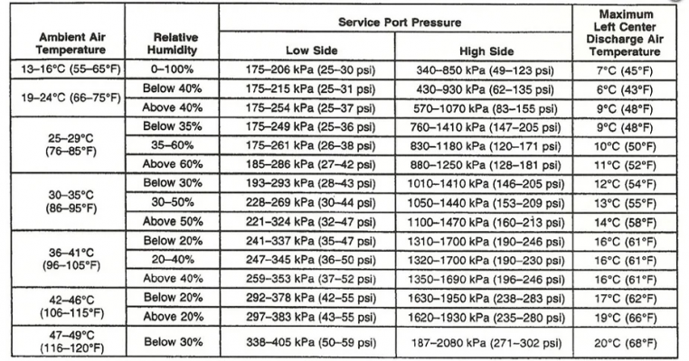

Both your Low and High pressures are way too high. You need 40-45 psi on the Low side and should see 200-250 on the High side. Let some gas out.

Relief valve is saving your life, 390# high side is dangerous. When gauges are attached, is the high side gauge needle steady? Assuming we are talking about your '01, only expy with 62 oz. charge and 11 oz of pag. So you added 8 oz's to a system that only holds 11 oz and already had oil in it. Proper procedure would be to drain and measure the oil in the compressor before replacing. Most of the oil charge lays in the bottom of the condenser and the compressor, when the system is off. There is no doubt you have way to much refrigerant in system with those pressures, how are you weighing in the refrigerant? What did you use besides air to flush lines? Air will not remove all of the oil.
