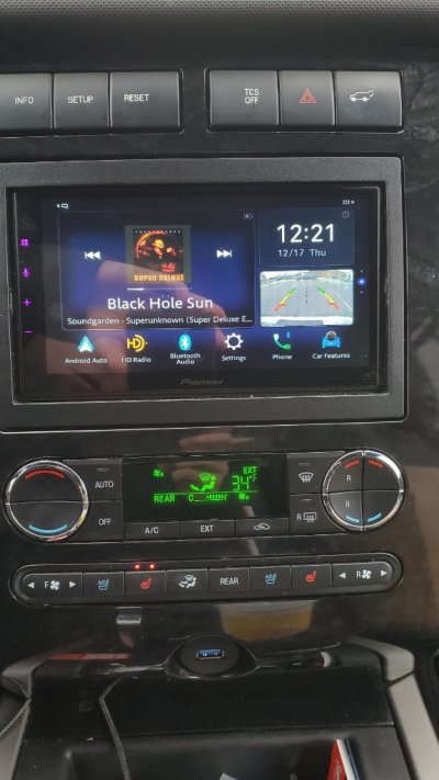

Got the head unit installed today. Looks great!!! I didn't realize that the Maestro RR wouldn't integrate the factory bluetooth mic though, so I need to pull it out of the dash again. The sound quality of the factory speakers has been greatly improved!
I ordered a usb adapter to replace the 12v cigarette lighter below the radio. I will post pics of the finished product after I run the Mic and install the usb connector
14,561
888
Hampton, VA
No pics? Show ur work off
