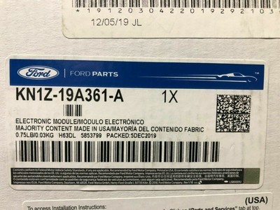

https://accessories.ford.com/products/ford-perimeter-plus-vehicle-security-system-20
This appears to be the ticket for the 2019+ expeditions. Curious if anyone has done this on their own without the dealer doing it? I have a couple recall things pending, maybe I will just have them do this when I take it in. $50 for install isn't bad...
Yes, I installed the Perimeter Plus module on my 2021 Expedition XLT (200a).
Got the unit off of ebay for $129. It said it was for a Ranger, but I verified the part number works with a number of vehicles including mine.
KN1Z-19A361-A​
Installation was easy, it hooks up in-line with the back of the OBD port. I found a small ledge just above the port and used the included zip-ties to secure it to the framing.
The only fiddling I did was some adjustment to the sensitivity knob for the security/bump feature.
Using the stock remote, press Lock-Unlock-Lock and it starts right up.

@MikePA Thanks, I assumed it was plug n play but also wouldn't be surprised if it required a flash. The part you showed is also the same as listed on Ford's website and they show a big list of vehicles it works on, basically almost all the 2019+ vehicles used the same module. I will have to do an ebay search and see if I get lucky like you did.

Is it possible that in the same year and model there are two diffrent parts
I wanted to install also Remote start
2019 XLT (i think its 201A - leather power seats, big screen)
and it shows me
JS7Z-19A361-A
not
KN1Z-19A361-A
any one know why??
