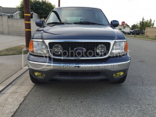

Thanks to Racenut for giving me this idea yeeaaaarrrs ago. We exchanged PMs and since then I have been wanting to do this. But life and a whole lot of other things got in the way. Unfortunately I dont think he posts here anymore. but anyway...
So finally decided on getting Hella 500 FFs. Theyre cheap, matches my clear lamps and quite easy to install. Although I still have to wire them, they will be part of the high beams

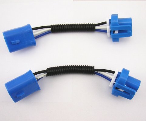

And get one of these so you preserve the factory harness

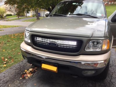

I've been meaning to do a post but I'm still in the process of a full lighting upgrade. Part of it was a front mounted 32" curved LED bar. It puts out a pretty ridiculous amount of light at night.

The clear fog lamps are not oem. Here is one in ebay → click
I bought mine years ago. theyre Depo brand and seem to be holding up well. I did put in yellow film similar to laminex and added 3500K yellow HIDs
