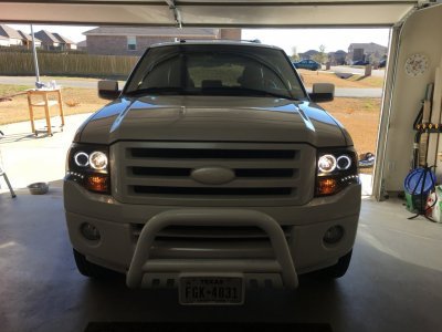

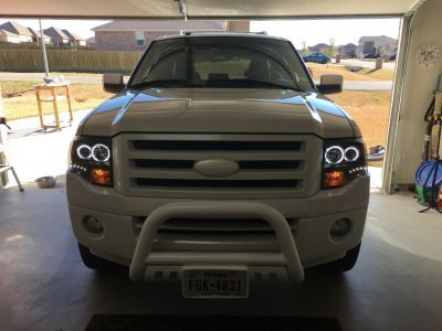

Any one got a set of the black housing after market headlights that look like the oem limited ones off eBay ?
Reason I ask because I did and looks great. But the problem is the hi beam sucks. You can’t adjust them either. The low beam is actually higher than the hi beam.
I have concluded that the cone over the bulb inside the housing is not centered properly.
So I’m returning them. Just wondering if anyone else has experienced this issue IMG_5988.JPGIMG_5567.JPG

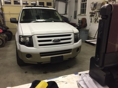

I have the same ones and mine were fine. However I am doing a retrofit on them so even if they weren't I wouldn't have cared.

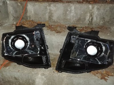

Put them in the oven. 240° for 10 minutes and they open right up. You may even be able to correct these if you don't feel like returning them. Or if your really feeling crazy open up these and your oem lens then just swap the reflector over to the aftermarket housing. As for sealing them back up I prefer retro rubber. In some cases you can even just press the lens back together after reheating and the original sealant will do it.

Do u think I’m on he right track about the bulb cover being the issue? Looking at my pic

Yeah the anti glare shield may not be aligned correctly. If you remove the rubber on the back of the housing you can probably tell if its not seated correctly because they screw in and mount from the back. Just be careful because if you unscrew it and it falls in you need to open the lens to put it back on
