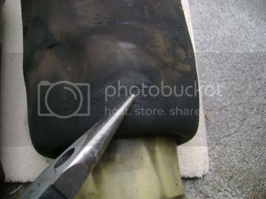

I have noticed lately that the air suspension of my expy deflates when parked for a day or so.
Thats an indicator of leaking bags.
Switch off the compressor, raise the rear and look for cuts on the lower portion of the bags
Mine looked like this

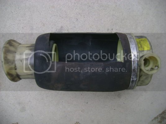

Comparison - new and old
decided to cut it up
