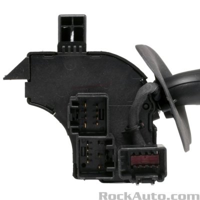

Do you have a multimeter to check for voltage back at the tail light harness plug ? Any voltage up at the third brake light assembly in the liftgate ? Do your hazard flashers work in the back ? Reverse lights work ? The Multi-Function Switch (your turn signal stalk switch body at the steering column...) is a common point for much of the light functions of both the front and rear light assemblies harness.

You will find the wires lead from the multifunction switch on the steering column all the way to the tail lights. You should be able to find them in that wire bundle behind the driver's kick panel. Just unwrap the electrical tape to expose the wires. Rewrap 'em when you're done.
https://www.rockauto.com/en/catalog...cal-switch+&+relay,multi-function+switch,4580
