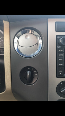

4x4 vehicles with the center console mounted shift knob have either:
A) 2H and 4A only if they are equipped w/o FX4 or HD tow pkg
or
B) 2H, 4A and 4L with the inclusion of a selectable electronic locking rear differential if they are equipped with either FX4 or HD tow pkg
4x4 vehicles with column shift lever and dash mounted 4wd selector knob has 2H, 4A, 4H and 4L.
Are you sure about that? I thought all 2018 Expys have the center console mounted shift knob and Drive Mode selectors, and that the FX4 and HD tow package have the 2H, 4A, 4H and 4L system.
Rcompart nailed it
Fleet vehicles in XL trim have column shift so they can be fitted with a patrol console in police/EMS/fire vehicles.
