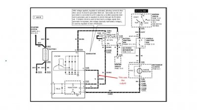

My battery light is on all the time. Thinking that it was a bad alternator and without testing the old one, I bought a new alternator. The battery is also new. I have checked the wires and nothing seems to be out of the ordinary. The main issue is that the alternator does not seem to be charging the battery which leads to a constantly drained battery. What could be going on?
