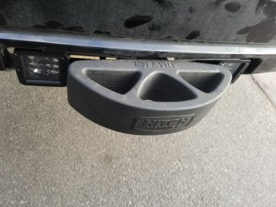

Guys 1st i do not use the tow. 2nd wanna share my finding. The reverse cam at night always not so clear especially the 360 cam. What made it alot clearer is when i installed two 3x3 inch led fog lights on bothside of the tow hitch. U know the space on either side of the tow hitch. I connect the foglights to the reverse lights. Now when i back up there imare 2 super bright nightt on at the back. The camera just see and display alot better with brighter back up lights.. just want to share
