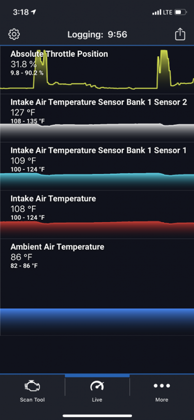

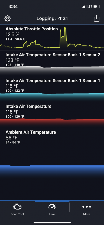

I have attempted to gather some relevant data on this and it appears I might be correct.
I took the Beast on 2 identical runs and removed the blow off valve plumbing before the 2nd. Approximately 5-10 minutes elapsed between the 2 readings.
With blow off plumbing attached:
With blow off plumbing removed:b5982d952ef591f8f2a8be134825853a.png
