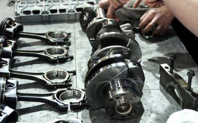

Here's the only shot of the 3.5's crank I could find and it reveals insert bearings (for both rod & mains) instead of split ball or rollers. We press many of the cranks on the older engines so they can use regular ball bearings but due to the forged(massively stronger) crank on the 3.5EB, regular bearings can't be used because the races would be kinda hard to slip a bearing past the porkchops<LOL>!
Now I'm not going to knock inserts correctly done. Honda has built empires in both auto and motorcycle engines on insert bearings coupled with high oil pressure and as long as that pressure remains, they are an excellent choice...but if the oil stops....or the power exceeds the crush strength of the inserts, it could be bad, real bad...(read as:expensive). There are better-than-stock replacements out there but you all know what's involved to swap them but an "extra" 20-30HP should be attainable without too much worry just by raising the boost pressures a few PSI.
