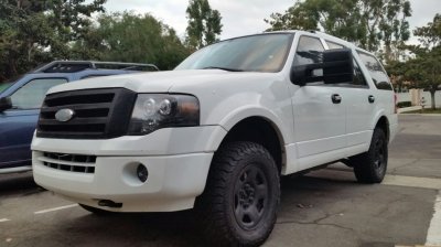

Pretty badass, right?
Trailridge, Made in Taiwan, $265 shipped for the pair, ordered from 1A but thru Amazon for free shipping & 5% cashback.
...still wish they were $120 - 150 like F150 or F250 versions, though. And the passenger side main glass was indeed straight flat mirror, no curve to it, might end up having to hunt down a replacement

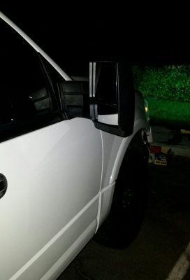

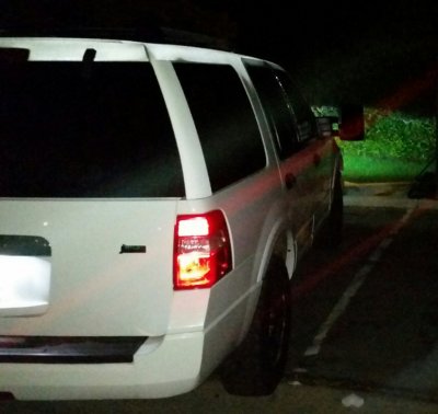

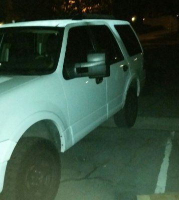

Sorry bout the bad pics, they too dang black to get good nighttime cellphone camera shots against a white car
PS install is fairly easy, need a small flathead to pop the screw covers, largish phillips screwdriver and a 7mm socket on a screwdriver handle or extension for the door screws, and - oddly - what seemed to be a 3/8" socket for the mirror mount (keep the nuts, included nuts are worse). Bungee cord passed thru the window to hold mirror and door panel as youre working makes it a simple 1 man job.
Door screws are 1 hidden by the handle, 2 hidden vertical ones in the armrest pocket thingie, 1 semi hidden on the side that swings out, and two along the bottom. Mirror is attached via three nuts that are either 3/8" or pretty damn close to it. Trailridge sent new nuts in a different size, but the old ones fit on the threaded rods so i just reused those

....Seriously need some clearance lights or at least reflectors, though

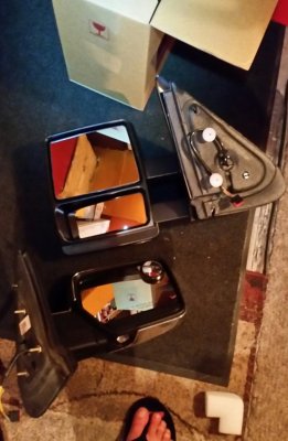

Power adjustment for "main" top mirror & allegedly heated.... manual fold / manual telescope / manual lower fisheye mirror adjustment
Didnt buy it for towing --- bought it for not seeing jack shit backing up and making an ass of myself parallel parking. Cheaper than backing into shit...
Also my stock mirror glass was looking kinda "tired" anyway (scratched up AF for some reason)....hoping to toss the original mirrors on CL, recoup maybe 150, and treat it as a slightly more expensive alternative to replacing the glass on that old shit
Oh and hey, imho them stock mirrors looked too puny.
