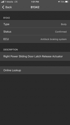

Went and got a basic ABS reader today...pulled code B1342... Can't really find any specific info on it...it's all basic info, apparently that code doesn't narrow anything down except there is a communication failure with the ECU somewhere...well...no sh*t‍♂️

Took it to my local, trusted mechanic this morning...looks like its ABS module, which has to be programmed by the dealer...guess I'm making a trip to the them over the next few weeks. He said it shouldn't effect the driveability just won't have anti lock brakes..
