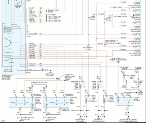

Thanks whtbronco. The expy started making that sound around 3 weeks ago, and maybe with poor decision making I was trying to find the solution myself rather than take it to the shop. About a week into it we noticed the low beams quit working, so I changed the bulbs. Those bulbs blew instantly, and since then I have changed out the fuse box, to no avail either.
I am learning about some of these issues and somewhat mechanically inclined, but definitely no pro. Would headlights blow like fuses, when there is specifically a short to ground?
I got off on the VSM failure track due to a wiring diagram I found on another forum, which shows that the headlamp relay is located in this. (I presume due to the lights being set up to flash when a theft occurs). If there is a short to ground somewhere or some corrosion in this module, I would assume this would cause some noise and issues.

Well you clearly have a direct short to blow the headlight bulbs instantly. If you think the VSM is faulty the electrical diagrams you posted provide a good place to start testing the electrical system. Just occurred to me you could check for continuity at the bulb connector. You shouldn't have continuity between the positive and ground with the bulb out unless they are shorted. It does look like in the diagram the headlamp relay is in the VSM/BCM so if you have continuity between the headlight bulb connector wires then you could unplug the BCM and try again.
