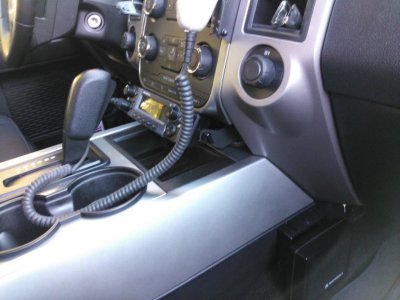

In my '05 (shown) I mounted my ham rig in the console with the control head above the coin tray. My '16 doesn't have any room in the console so I'm thinking of mounting the entire radio on the right side of the console facing up in order to see the controls.
